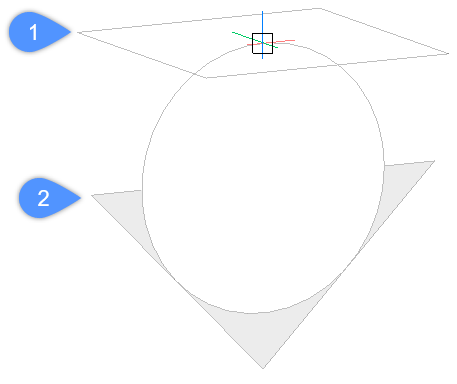

Creates a BIM Section entity with the section plane (1) in the XY-plane of the current coordinate system (WCS or UCS) and the view direction (2) in the negative Z-direction of the current coordinate system.

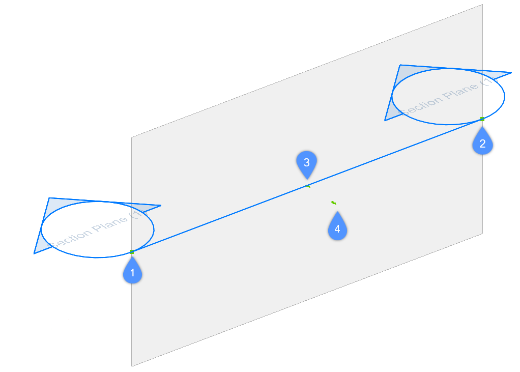

- Plane state:
- Start grip (1) allows you to move the section and the position of the Start callout.
- End grip (2) allows you to modify the orientation of the section and the position of the End callout.
- Center grip (3) allows you to move the section and the position of the Mid callout.
- The arrow (4) flips the view direction.

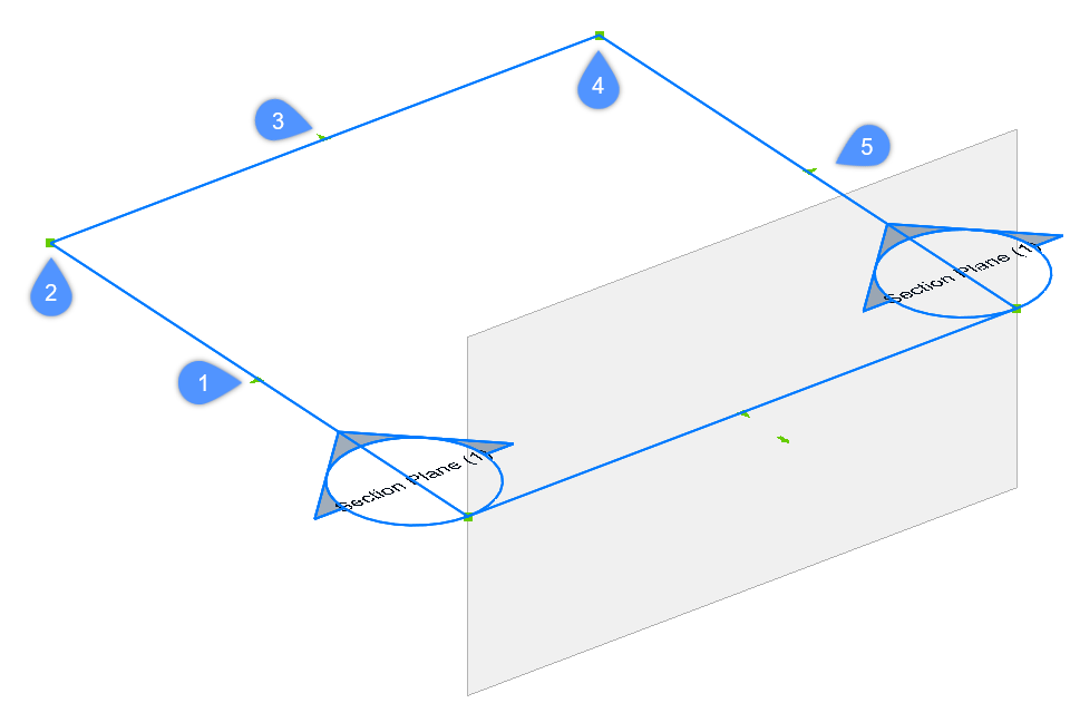

- Boundary state:
- Midpoint grip (1) allows you to move the section entity.
- Corner grip (2 & 4) allows you to deform the section boundary/volume.
- Midpoint grip (3 & 5) allows you to stretch the section boundary/volume.

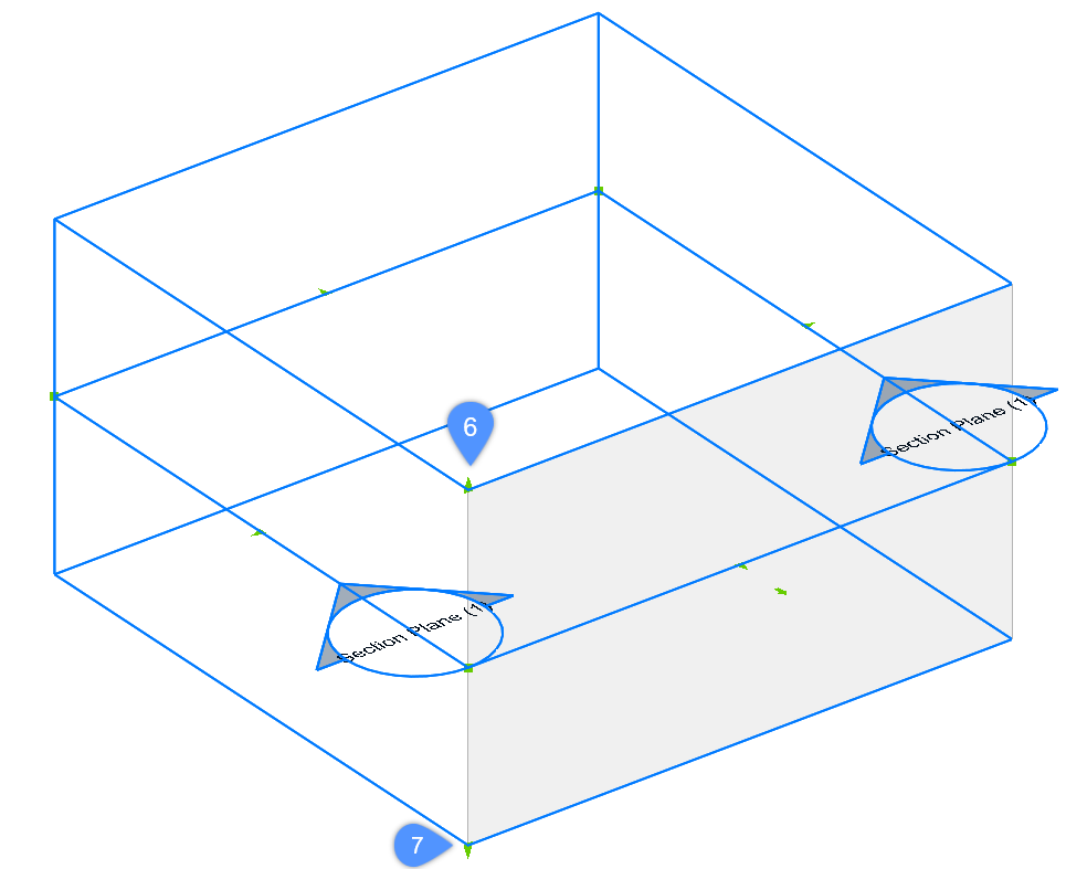

- Volume state:
- (6) allows you to move the top plane of the section entity.
- (7) allows you to move the bottom plane of the section entity.
