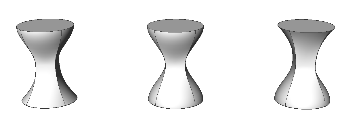

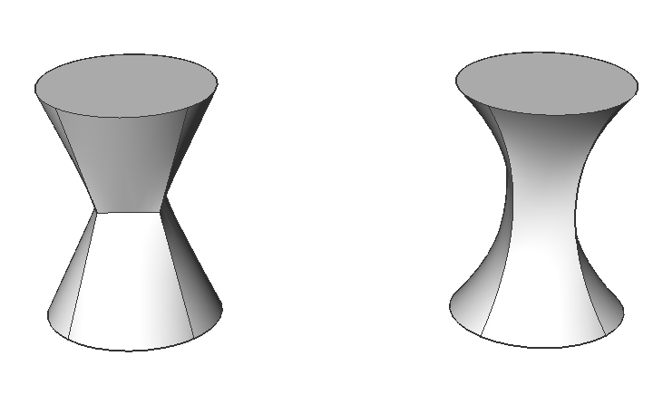

Ruled
Draws straight surfaces between the cross sections, features sharp edges at each cross-section.
Note: When the Ruled property is ON, the Normal type property becomes read-only.
Smooth fit
Draws smooth surfaces between the cross sections.

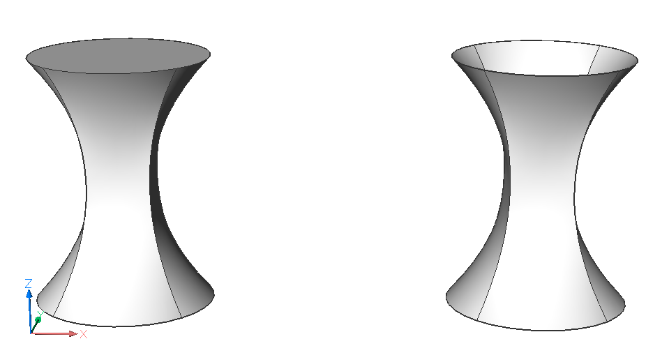

Normal to
Draws surfaces normal to the chosen cross sections. Select one of the options to become one of the following results:
  • Start
  • Both
  • End
  • All
Note: LOFT entities created along a guide or path while the CREATESKETCHFEATURE system variable is ON have the Normal type property from the Mechanical Browser panel read-only.

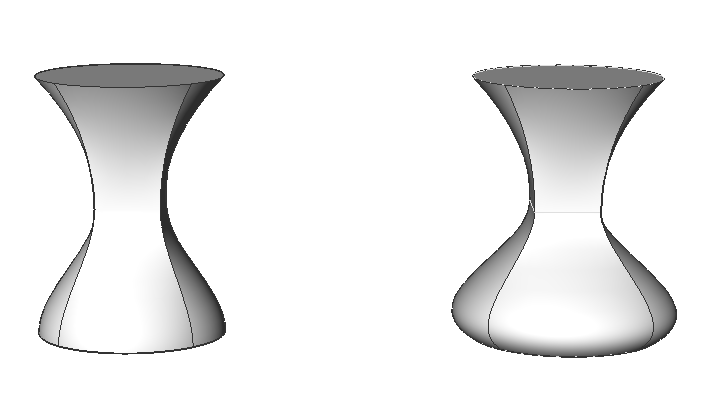

Draft angles
Specifies the angles at the starting and ending cross-sections to modify the loft shape.
Note: The angle option specifies the angle at which the loft starts from a cross section. The magnitude option sets the relative distance of the surface from the cross section in the direction of the draft angle before surface starts to bend towards next section.
